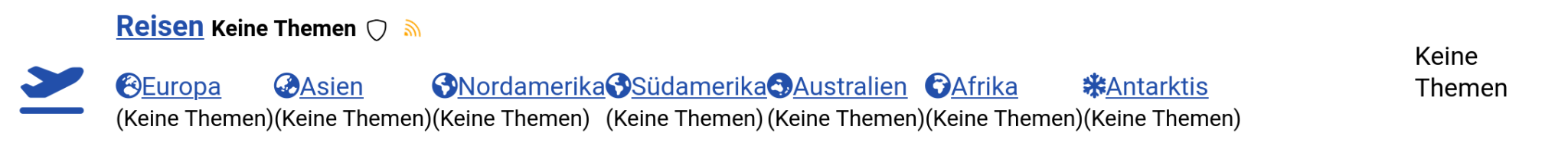

Hello,I have noticed a small layout issue on the category index view, specifically concerning the display of subcategories when icons are enabled and subcategory names might be long.The Issue:When displaying subcategories horizontally (e.g., under a parent category), there appears to be insufficient spacing in two areas:
  1. Between adjacent subcategories: When icons are used and/or subcategory titles are somewhat long, the different subcategory listings (including their icon, name, and the "(Keine Themen)" / "(No topics)" text) run very close together horizontally, making the layout look cramped.
  2. Between the icon and the subcategory name: The icon assigned to a subcategory is positioned directly next to the subcategory title text, without any visual separation (padding or margin).
Please see the attached screenshot:
The screenshot shows the "Reisen" category with its subcategories ("Europa", "Asien", "Nordamerika", etc.). You can observe how the elements lack spacing between them, both between different subcategory blocks and between the icon and text within each block.
I'm using Kunena version 6.4.1 with Joomla 5.2.5 and the Cassiopeia template.

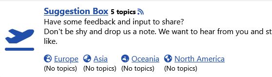

Can  you check if it looks better when you add this to your custom.scss?
.category .list-inline li.float-start:not(:first-child) {     padding-left: 10px; }
What wonders me is that your icons are so close to the text. That shouldn't be according to the the definition in general.scss line 821:
ul.list-inline .glyphicon, ul.list-inline i {     padding-top: 2px;     padding-right: 5px; }

Can  you check if it looks better when you add this to your custom.scss?Code:.category .list-inline li.float-start:not(:first-child) {     padding-left: 10px; }
I added it to user.css and it helped to make the distance between the subcategory names.
I thought maybe my user.css was breaking the template, but after deleting it, nothing changed with the distance.
Last edit: 1 year 5 months ago by Opendreas.

Strange. Do you have a link to your site? With the change I proposed for me it looks like this:
