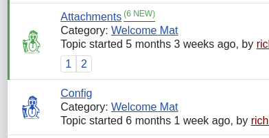

Ok, so, if we select Font Awesome, or we select SVG and pick any of the SVG that come with Kunena, we get the SVG color change with CSS effect when there is a new post i.e. the colour of the SVG changes using css.
But, if you download a Font Awesome icon (so we know this has the ability to change colour with CSS), switch the site to use SVG (not Font Awesome) then upload the Font Awesome SVG, then colour change doesn't work. So, I'm assuming that every SVG must have some code somewhere to tell it to change? Where abouts is that code located, so we can manually add it for any uploaded SVG?

3 years 2 months ago #229299 by Konsider
Replied by Konsider on topic SVG color change with CSS
Ok, I added that code. Then I changed the font setting from Font Awesome to SVG. Then, I uploaded a Font Awesome icon (because we know that can colour change) as one of my own SVGs. I set it to be the icon for a category. The colour doesn't change.
