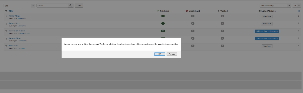

5 years 8 months ago #215154 by xillibit
I have looked how it does with the menu component of Joomla!, it delete too in same time the module associated with the menu, but you have a hin before. So we can add a hint before to launche the action :
