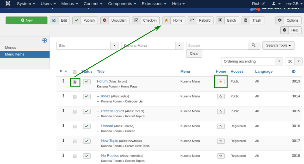

6 years 11 months ago #211384 by rich
Go in the backend to Menus -> Kunena Menu and mark the first menu item (Forum) as Home.
