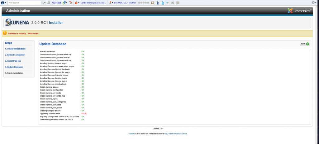

When upgrading from Version 1.7.2 to 2.0 RC01 in Joomla version 2.5.4 a complete crash and freeze of Kunena occurred.
only one error was displayed during process (see screen shot)
Clicking "Next" button does nothing

For all menu items on your site that relate to Kunena, remove those menu items and trash the menu. Then try the installation procedure again.
This may be a bug in the installation procedure that fails to work with some existing custom menu items that you may have created.

sozzled wrote: For all menu items on your site that relate to Kunena, remove those menu items and trash the menu. Then try the installation procedure again.
