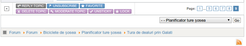

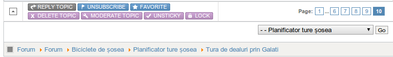

As an Admin I see all the messages and the pagination is OK (in this case I have 10 pages including deleted messages).
As a Moderator I don't see the deleted messages and I see only 9 pages (this is OK).

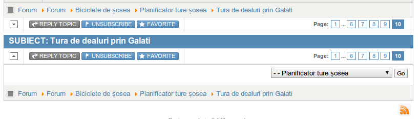

But as a normal user I see an empty page 10, because I am not able to see the deleted messages but I believe they are still counted somehow.
Did anybody saw this problem? Am I doing something wrong?
