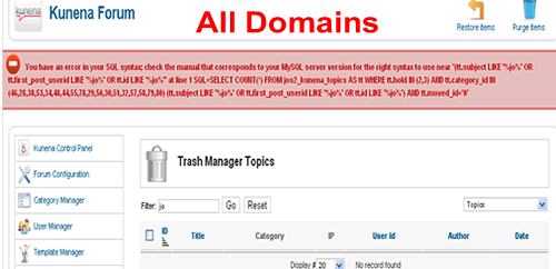

I have since found this SQL syntax error is on every site, but who checks ‘Trash Manger topics’ for errors when you have no trash to check !!

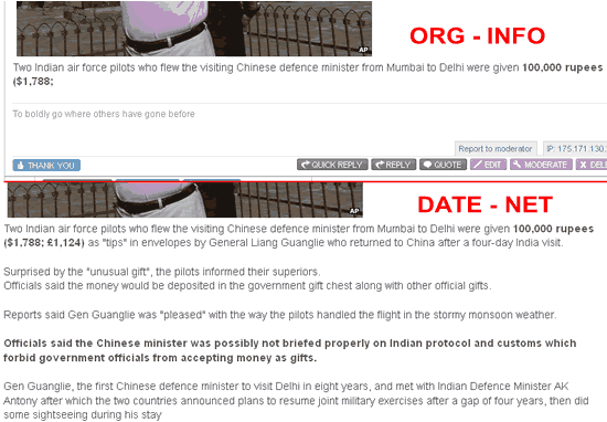

Since the upgrade to Kunena 2-2 on ORG and INFO the amount of text in each posting has disappeared which means that I have to check and edit some 22992 forum messages and copy them from DATE which did update OK.

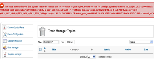

So the way to reproduce this problem is to use the Kunena Trash Manager on a forum that has many messages but no deleted (trashed) posts. Is that a fair summary of the way to reproduce this problem?

yeah if you search in the Kunena Trash Manager TOPICS you may get this

14 years 1 month ago #134511 by xillibit
Replied by xillibit on topic SQL syntax
To fix the issue, open /administrator/components/com_kunena/models/trash.php and replace line 146 :
if ($this->getState ( 'list.search')) { $where = '(tt.subject LIKE '.$db->Quote( '%'.$db->getEscaped( $this->getState ( 'list.search'), true ).'%', false ).' OR tt.first_post_userid LIKE '.$db->Quote( '%'.$db->getEscaped( $this->getState ( 'list.search'), true ).'%', false ).' OR tt.id LIKE '.$db->Quote( '%'.$db->getEscaped( $this->getState ( 'list.search'), true ).'%', false ) . ')'; }
by
if ($this->getState ( 'list.search')) { $where = ' AND (tt.subject LIKE '.$db->Quote( '%'.$db->getEscaped( $this->getState ( 'list.search'), true ).'%', false ).' OR tt.first_post_userid LIKE '.$db->Quote( '%'.$db->getEscaped( $this->getState ( 'list.search'), true ).'%', false ).' OR tt.id LIKE '.$db->Quote( '%'.$db->getEscaped( $this->getState ( 'list.search'), true ).'%', false ) . ')'; }
14 years 1 month ago #134518 by xpatman
Replied by xpatman on topic SQL syntax
Hi
That has fixed the SQL syntax error in the Kunena Trash Manager.
