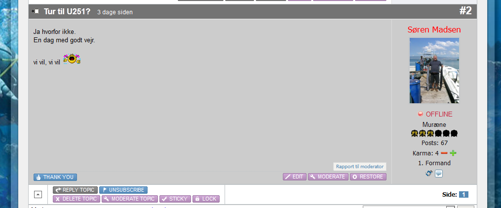

Question How do I delete a post?
In 'the old days' on 1.7.2, I could then delete the post for real, but I don't see that button now?
What then?

As per your kind suggestion, I've also tested the delete issue with a full width view of kunena (more that the minimum of 700px).
I still do not see a delete button.
