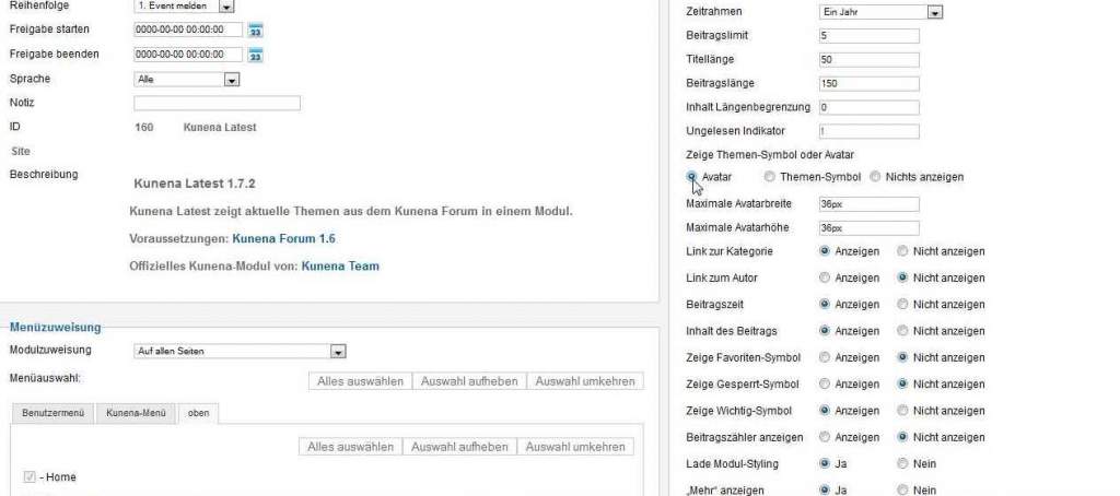

14 years 4 months ago - 14 years 4 months ago #128112 by plauncher
i have the same problem and others in the german section too. i installed the 2.0.1 Files now and its always the same. if i activate the "show avatar>" option, there is first only a big point on white backgroung at the left top of the screen (no website visible, just white and the big pont), and later (maybe if the cache is renewed?) a fatal error:
"Fatal Error was detected!
Fatal Error: Call to a member function getLink() on a non-object in modules/mod_kunenalatest/tmpl/posts_row.php on line 15
The error was detected in the Kunenalatest Module."

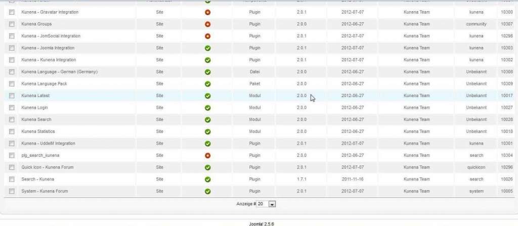

The other is the wrong version that will be showed in the backend: 1.7.2 but in the extension manager it shows 2.0.0!
