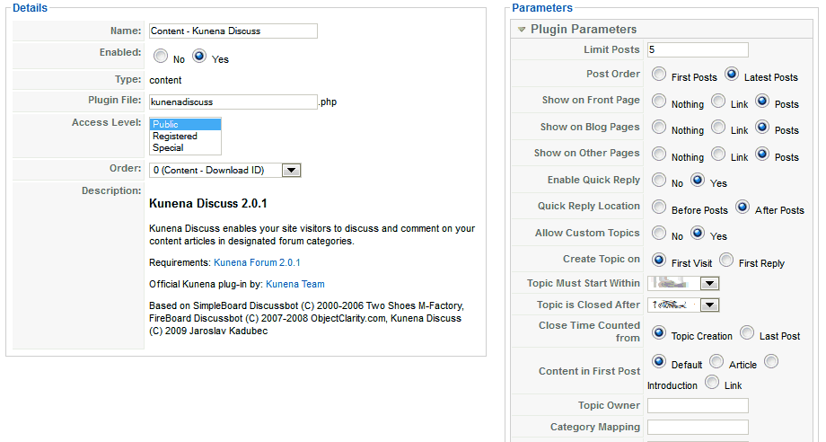

These are the settings for Kunena Discuss 2.0.1 used at this site:
How do your settings compare?

14 years 4 months ago #129223 by boskoff
thanks for answering.
I have the very same settings now, like you posted. With the option "Latests Posts" everything is OK.
