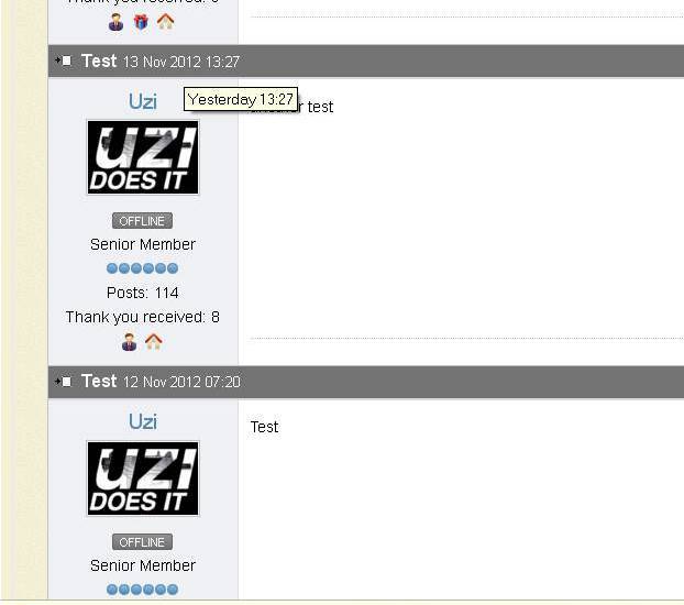

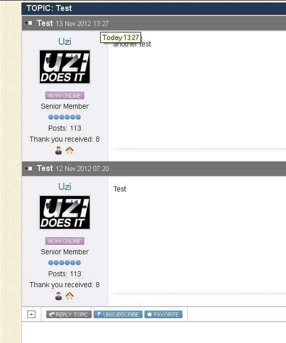

What is happening is this - I posted a test post at 7.15 am. The forum showed it as posted TODAY at 07.15. Correct but at around 5pm it showed posted YESTERDAY at 07.15. The only setting I can find in Kunena is in Config / Front End which also shows a strange time (about 1 & 3/4 hr ahead & yesterdays date)
To get round this I have the format set to "22 hrs 13 mins ago" but it still screws up statistics on what is posted TODAY.
Help
This is what I got earlier:
At 3.45 pm I checked again & it has changed AGAIN to show YESTERDAY
Note both show TODAYS date & Time correctly :huh:
Forum Statistics have also reset to show 'Total Open' zero TODAY when there were 2

Everything is working fine except for the forum date. I am in the Philippines & have Joomla set to Manila time & my forum user also set to Manila. What is happening is this - I posted a test post at 7.15 am. The forum showed it as posted TODAY at 07.15. Correct but at around 3.45pm it showed posted YESTERDAY at 07.15. The only setting I can find in Kunena is in Config / Front End which also shows a strange time (about 1 & 3/4 hr ahead & yesterdays date)
I tried again as seen in the screenshot below
Again it changed as below
