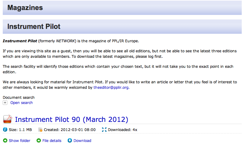

14 years 4 months ago #129698 by derekf
Please find attached file that I'm having the problem with.
