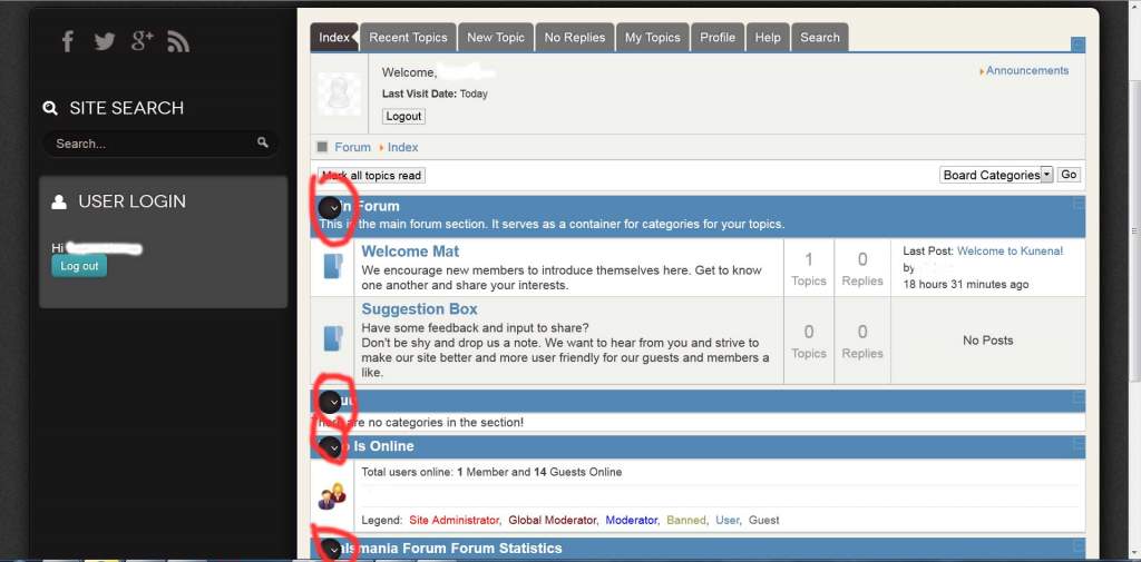

I am having this visual error with the Rocketheme Leviathan template and Kunena 2.0.4.
Probably it is something to deal with css, but i am not sure, as evertyhing works ok.
Joomla Version 2.5.8
Please Help. :(

13 years 8 months ago #139855 by Alder
hi I have seen this with this template as I have been customising it for my site. It is all to do with the h2 settings I found it using firebug and testing. I can't remember the exact bit I deleted but was on about before the h2 setting.
I hope this helpshelps
Dave
13 years 8 months ago - 13 years 8 months ago #140282 by b-mack
Goto:
/templates/rt_leviathan/css-compiled/master-20f0e70dbae7e03b725f8f9b47f7a501.css
and at the very end add this:
/*Kunena Fix*/
.rt-main-wrapper h2::before {display:none !important}
Hope it helps :)
Last edit: 13 years 8 months ago by b-mack.
13 years 8 months ago #140283 by hkymre
b-mack wrote: Goto:
/*Kunena Fix*/
Hope it helps :)
Or create a file /templates/rt_leviathan/rt_leviathan-custom.css and add the above to it - that way if you update your template you don't lose your overrides
