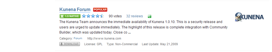

16 years 10 months ago #18832 by tallship
grumblemarc wrote:
Where does it state it is native? I think on the JED it does but that is most likely for the BETA relase of 1.5. It (1.0.xx) has never been. Even FireBoard was not native and had to have the plugin enabled on J1.5.
Yes, that is where it says it is Joomla 1.5 Native. I've included a screenshot for clarification.
Also, it says that 1.0.10 is the Joomla 1.5 Native component.
Thanks for your help grumblemarc :)
