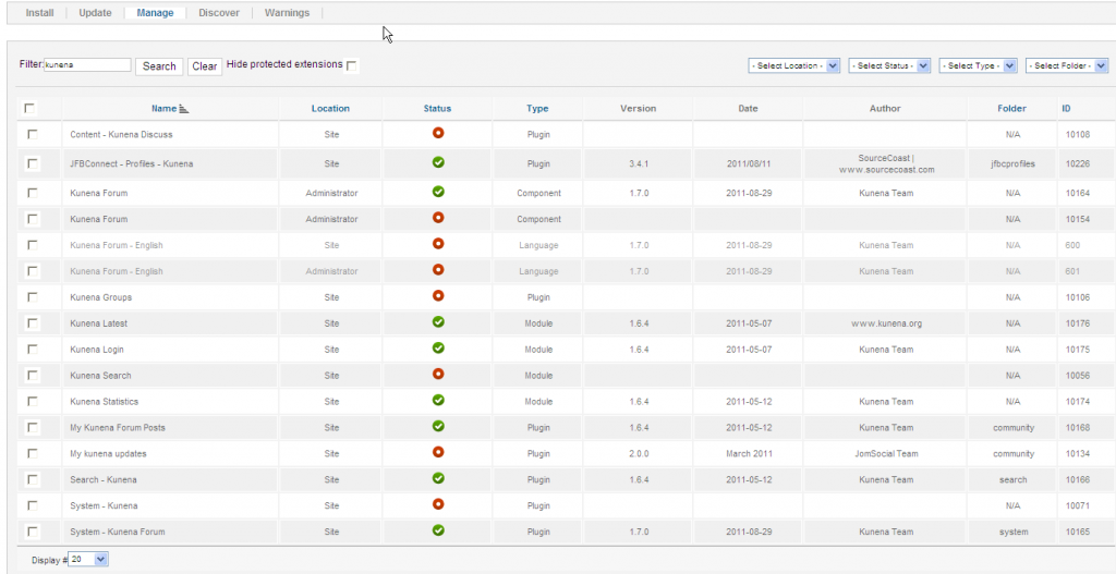

Everything seems to be working fine after a reinstallation, but the extensions shown in the attached screen shot are still there. You can see by looking at the list that some are almost certainly not "current" and appear to be just remnants of some sort.
I've had other components leave behind remnants like this a couple of other times. I was able to remove them from my database with phpMyAdmin and everything went fine. But with those I was able to find a very reliable, unique search string. With Kunena, I'm not sure what belongs and what doesn't.

This was a bug in JUpgrade that I fixed about 2 weeks ago. JUPgrade broke the database somewhat causing these dummy items without version to come up. The only way to delete them is to edit the database directly by deleting those extra entries (just be careful to delete the right one)...
And that is what you did. With Kunena you should just pick the one with lower id (last column). The wrong one doesn't have version information in it.
