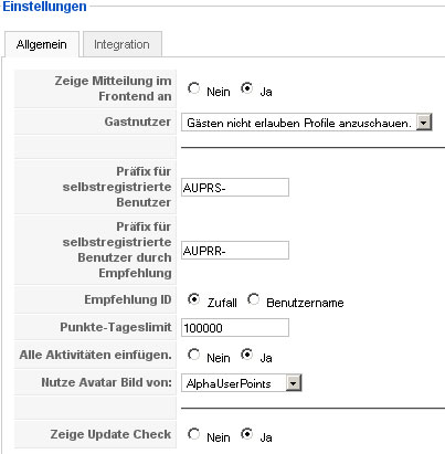

Here are any Picture.

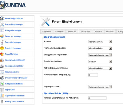

timi11 wrote: So I set uddeim to Yes - The site was broken!
Yes, of course. You can't say in Kunena that you want to use uddeIM if you haven't actually installed uddeIM.

sozzled wrote: Yes, of course. You can't say in Kunena that you want to use uddeIM if you haven't actually installed uddeIM

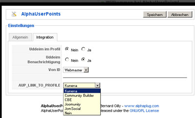

Same thing in AUP (see picture aup2.jpg)... you have there UddeIM (notications) enabled even that is not installed as Kunena report tell that.

Where you upload that avatar picture? You have to upload that from AUP profile because you use in Kunena AUP avatar integration... if you upload that from Kunena profile it not show...
