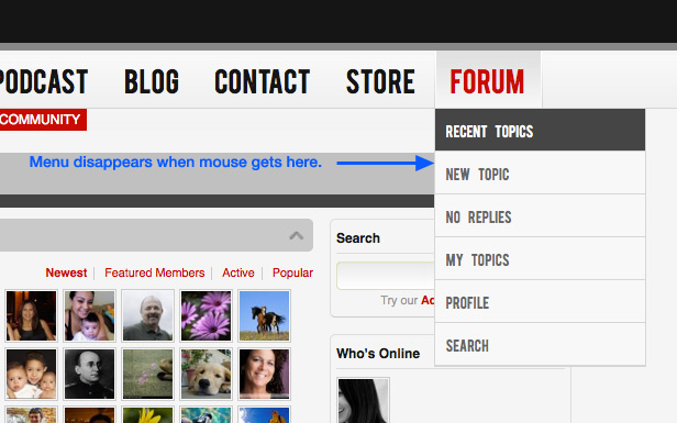

Anyone using Kunena 1.6 and Jomsocial? I'm having an issue where the Kunena drop down menu disappears ONLY in Jomsocial when you attempt to move down the menu. Seems like it could be a z-index thing. The Kunena drop down displays fine, but when the mouse hits the Jomsocial toolbar (the gray bar in the attached image), the entire Kunena drop down disappears. It only happens in Jomsocial. Any thoughts? Thank you.

For those of you using (or planning to use) Kunena 1.6 with Jomsocial, and are planning on using the Kunena Dropdown Menu, be sure to change the z-index of your Main Menu in Joomla. By default, the Jomsocial Nav z-index is 6600 which causes the Kunena Drop Down (or any other) to go all wonky. Simply up the z-index to something higher than 6600 and you should be good to go.
