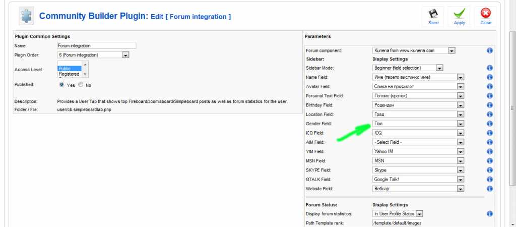

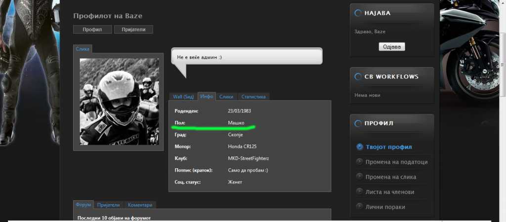

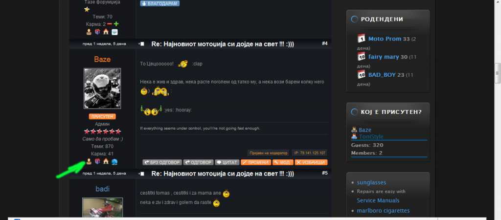

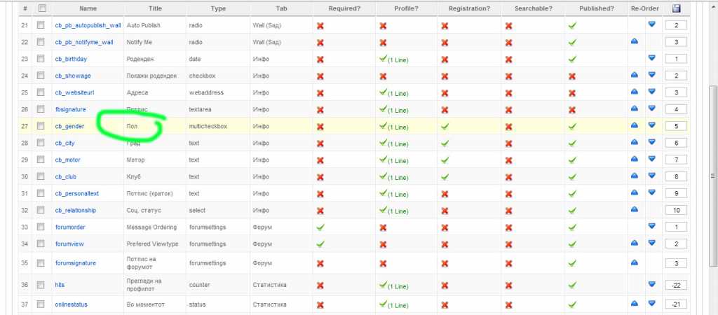

First of all I'm not sure if i should address this here or on joomlapolis site so sorry if it's on the wrong place.
I have problem with the gender icon beneath the avatar on the forum. In most cases it says undefined even thou the users have selected gender which is showing properly on their cb profiles.
1. The cb_gender field is named "Пол"
2. In the cb forum integration plugin i have selected "Пол" as gender field
3. On my profile page the gender shows properly (Пол: Машко means gender: male)
4. But on the forum the icon says "undefined"
Any idea what might be the problem?
