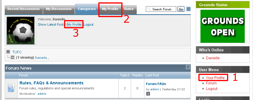

Have just upgraded to Kunena on a J1.5.9 site from Fireboard. Am also using CB 1.2 Stable
My issue is this.
1. Link goes to correct CB profile - url ..../index.php?option=com_comprofiler&Itemid=128
2. Link goes to a broken link - url ..../index.php?option=com_comprofiler&task=userProfile&Itemid=21&user=100
3. Link goes to a broken link - url ..../index.php?option=com_comprofiler&task=userDetails&Itemid=21
What am I missing in the integration? I have enabled the Fireboard plugin and tab in CB, selecting Fireboard as the option.
In Kunena, I have selected CB as integration, and created the user tables, and synched the users.
Please help
Cheers
Danielle
