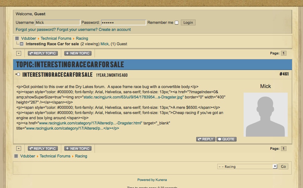

G'day all.
I'm in the middle of writing a migration script to migrate from Dolphin to JomSocial. For the forum component I am using Kunena (of course
) but have struck a bit of a stumbling block with regards to post formatting.
Dolphin uses TinyMCE as a WYSIWYG editor and after filtering the input the posts are stored in the database as HTML. Kunena escapes the HTML so that when it is displayed, the HTML code tags are displayed in the post, and not parsed as expected.
I started to write a HTML to Kunena BB parser to convert the HTML into Kunena friendly BB code using RegEx, but found that due to the way that TinyMCE creates the HTML code, the HTML syntax is almost infinitely varied which is a bit of a headfark to code as each possible variation needs to be considered. :blink: :side: :pinch:
Before I embark on spending hours writing an overly complicated parser, Is there any way to (easily) allow the HTML to be displayed? Maybe there is another better way?
I've read the posts relating to Kunena policy on HTML editors (interesting thread that one :silly: ) and can appreciate that what I a asking may be considered a security issue, but I would counter that the posts being migrated have already been filtered, and all subsequent posts will utilise the standard BB code.
Any help / comments / suggestions greatly appreciated.
