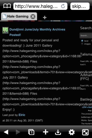

I'm almost to the point of going ahead and using this module as my front page news except for the following:
1) Any links I have in my post are shown as the full link instead of being parsed.
2) The module doesn't follow the line breaks of the original post - it just runs everything together.
I just upgraded everything to 1.7 and I'm running a Joomla 1.7 site. Any help would be greatly appreciated.
Thanks! :)

15 years 2 months ago #105810 by jhale1966
The original post is here:
www.halegaming.com/index.php?option=com_...=36&id=33&Itemid=505
And this is what it displays:
(hopefully it comes across)

15 years 2 months ago #105825 by jhale1966
Correct - the links back to the author and topic itself work fine. I also have the module displayed only to special so no one sees it but me. :)
Is there a chance to have the module altered to keep the format of the original post as well as the internal links?
Maybe make a new module called Kunena Articles. :D
15 years 2 months ago #105867 by Matias
Actually you can keep the formatting, just change the module template not to clean bbcode (use ::parseBBCode() instead)..
