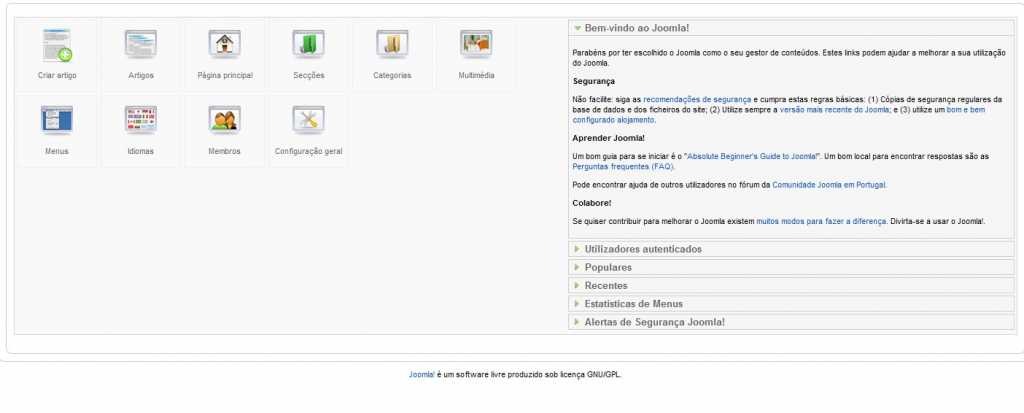

I never see that image before I will try explain with images.
I have this version installed( clean install)
Now, I tried to install k 1.6.1 and I wait for the end
then appear that the first page ( control panel)

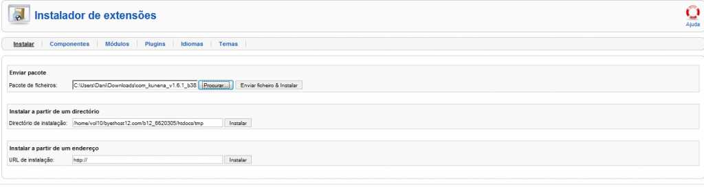

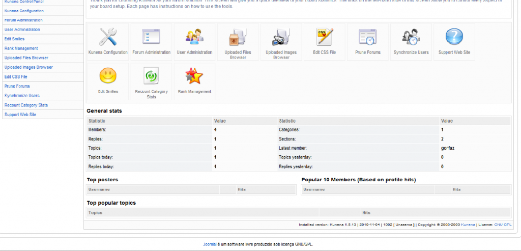

The first picture shows what looks to be the K 1.5.13 control panel. This is where you currently are.
The second picture shows that you are starting the procedure to install K 1.6.1 but, for some reason, you don't see the next screen (which I posted in my message above). There could be a very easy explanation for this. It might be that your website does not permit the upload of installation files that are larger than 2 Mb. There is a workaround for this problem. See [solved] how to install Kunena 1.6.1?

finnaly I have some error "failed to open stream: no suitable wrapper could be found"
15 years 6 months ago #69455 by dfgd
Replied by dfgd on topic upgrade from 1.5.13 to 1.6.x
thank you for your help know I found te image you send to me if this process result I tell you on this post.
thank you
15 years 6 months ago #69456 by dfgd
so, I send the files by ftp to the server and then I proceed with the installation.
every thing is ok, green on install.

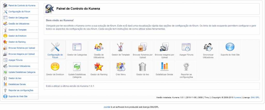

Now I've this, k 1.6.1 working and on Pt-Pt
Thank you, I hope this episode help someone to solve problems with the upgrade
