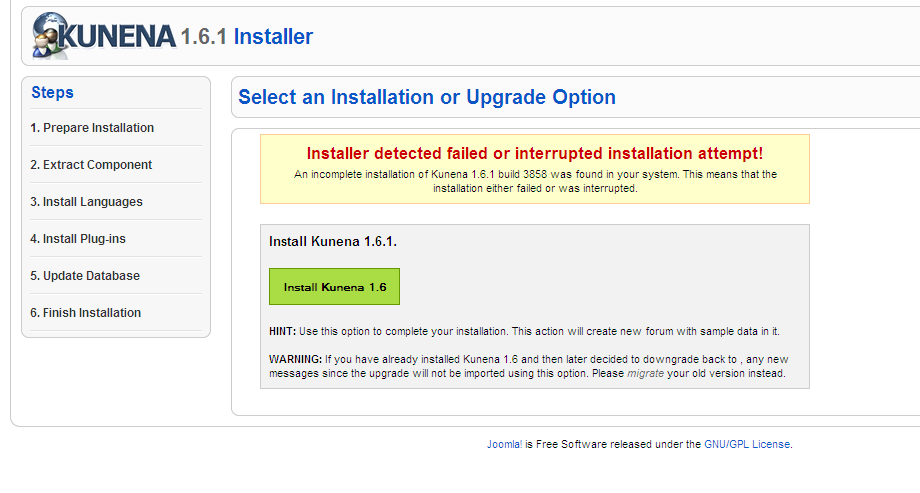

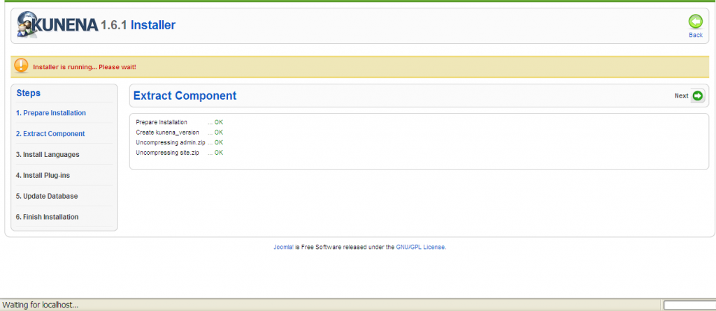

Now, I downloaded this latest package 1.6.1, when I installed it on the Justhost web hosting server, during the below installation screen, it was suddenly logged out back to the Joomla Administrator Login screen.
When I login back to Admin, it is said that Kunena 1.6.1 was installed but I doubt if it will be stable. Then I re-upload and install the package, it prompts me 2 options whether to Reinstall or Remove 1.6. I selected Remove 1.6 and it was prompted with a successful uninstallation msg.
I re-upload and install the package again, when I clicked install, the following message was shown.

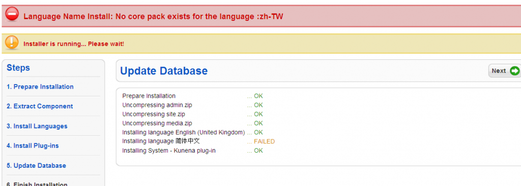

I found the problems already. After I cloned and restored the Production Site onto my laptop from the Justhost server, I tried installing Kunena on the restored version on my laptop. The following error screen prompted but it didn't logout to the administrator login page as on the Justhost server.

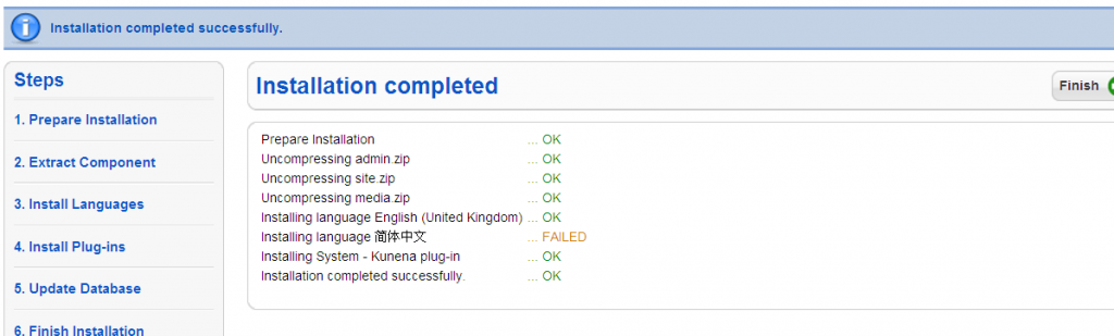

It carried on until the following screen showed.
On the Justhost server, these 2 error screens NEVER showed but immediately logout to the administrator login page when the problem hit. Why is it so ?
I only installed Traditional Chinese language for the Front-end, not backend, why does it bother with Kunena 1.6.1 during installation ? It took me 10 hours on troubleshooting and the problem is bcoz of this language issue.
Sigh, bitter experience again and Kunena 1.6.1 is yet stable in terms of installation. I'm wondering why Justhost server didn't prompt the errors. Fortunately, my laptop did, otherwise I won't know the issue behind until the doomsday, wasting me so....much time on this silly bug.
