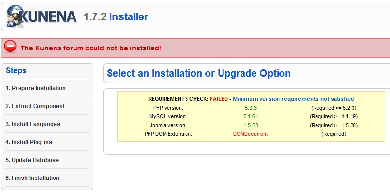

I can't install Kunena 1.7 on my Joomla 1.5 running on CentOS. I have attached the picture about the error message. Do you know what's wrong?

catonakarin wrote: I can't install Kunena 1.7 on my Joomla 1.5 running on CentOS. I have attached the picture about the error message. Do you know what's wrong?
Your screenshot shows is all, your host does not have the minimum requirements to run Kunena.

Of course that the host does not have the minimum requirements to run Kunena. But the point that I upload the picture is I want to know which part of the host should I upgrade to satisfy Kunena? 'cus as shown on the picture, we can see that my php, joomla, and mysql are all beyond the minimum requirement. Do you have any idea?
Yes, we all know, and I think we're all wondering why you don't.
Things in green are good, things in red are bad.
So, in red, your image shows that you are missing the PHP DOM Document component. That means your php installation is incomplete, faulty, out of date or something similar.
