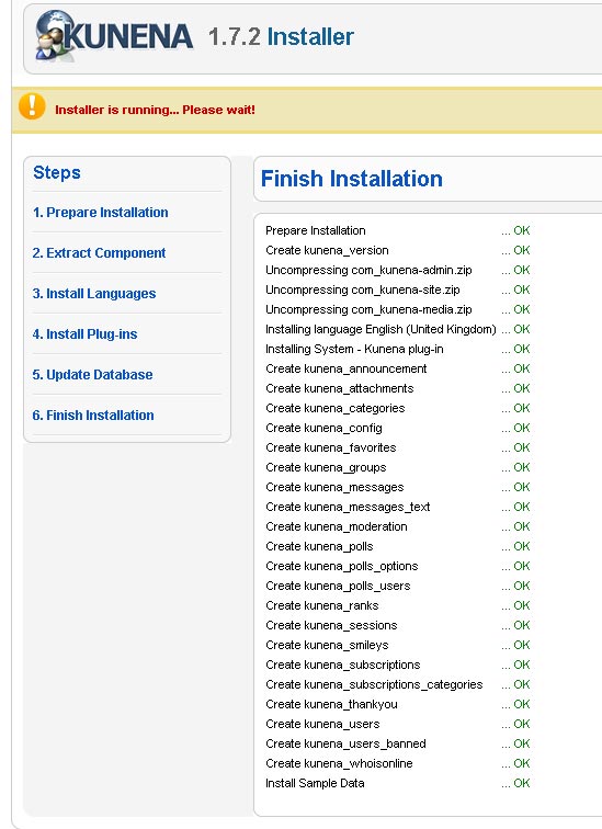

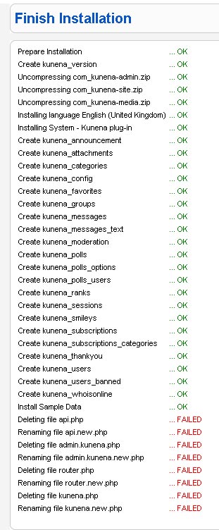

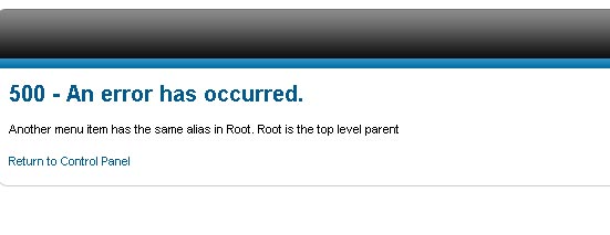

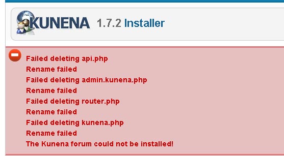

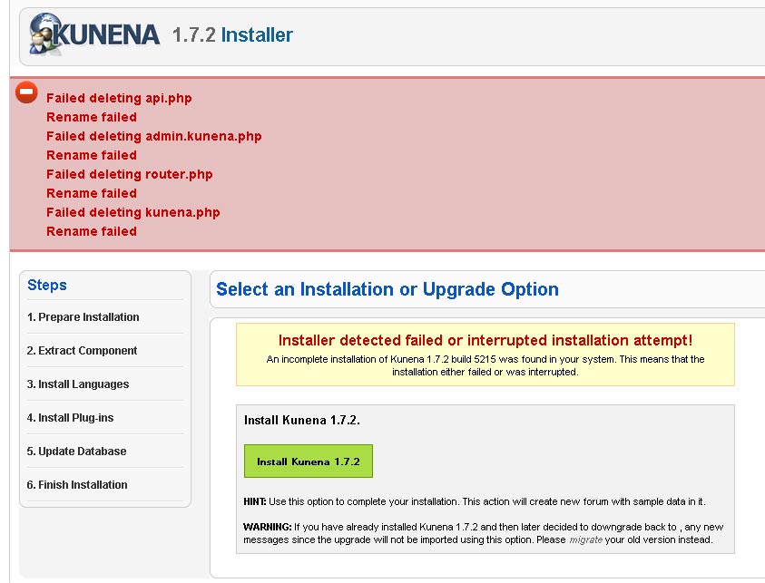

Hello everyone,
Been having a very tough time trying to install the latest Kuena on our Joomla 2.5. Our PHP and server requirements far exceed what is required by Kuena. Our Joomla version is 2.5.4. All necessary folders have write capability, otherwise we wouldn't have gotten as far as we have with this installation.
Every time I try to install Kuena it looks like it gets through to installing sample data and then throws a Error 500.
I've attached screens of what I've run into. I even tried deleting and renaming the files thrown in the error, but no luck.

G'day, MMPatriko, welcome to the community and I'm sorry to hear that you're having problems installing Kunena.
The problems started when you had "another menu with the same alias in the root" and went on from there. It looks like you've got become bogged down with Joomla getting itself into a mess (in your case) and, unless there's anything particularly important that you want to salvage, you may want to consider starting all over again. Do you have a backup of your website before you first tried to install Kunena? That might be a good place to go back to.
When people run into almost impossible-to-solve difficulties, I ask them to consider the when-all-else-fails-try-this approach. (see When all else fails, try this .
You have a second menu item on your website called "forum" (or with the alias name "forum"). Remove it.
