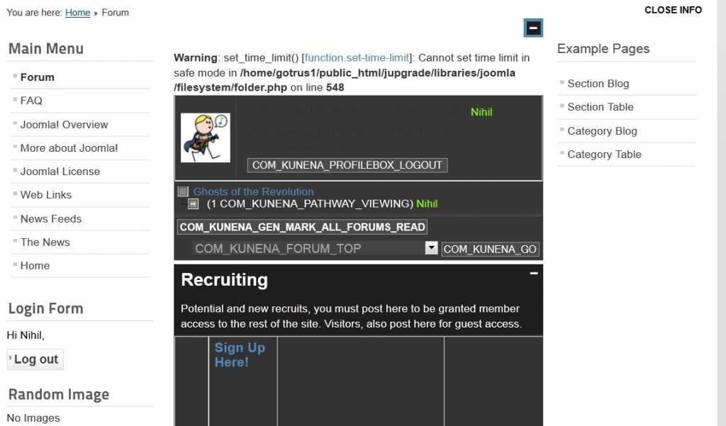

i'm trying to go to 1.6 using JUpgrade. In the test environment, Kunena looks all kinds of messed up. That was after doing the discovery and update thing. Before that i couldn't get to Kunena at all.
Are there steps to get it to look right?
The pic shows the variable names or something and the shapes are all jacked up. Is that because i haven't moved it to the live site? It's still running in the /jupgrade folder.

I would just download and install the latest Kunena release after migration. Discovery/update isn't working well with Kunena.
The warning you get comes from Joomla, not Kunena. You should report a bug from it (just the warning text) and they should know what to do with it (they just need to suppress that warning by @).
