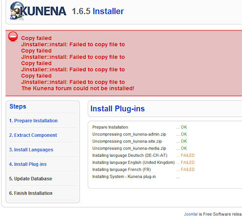

15 years 1 week ago - 15 years 1 week ago #102902 by kiwi3685
Managed to get a little further today, but still fails. I set all those directories and contents to 777 (excessive I know, but I was desperate). I also tried to install from uploaded directory instead of from URL (not able to do that) or upload/install.
This all got me a little further, as shown here:
At that point I had to revert to 1.6.3. In doing so it highlighted a problem with permissions on the /administrator/components/com_kunena/archive folder. That seems to fit with the failure to copy languages shown in the results image. It looks like I need to talk to my web host about that, as it appears to be an ownership, rather than permissions problem - unless you have any other suggestions?
