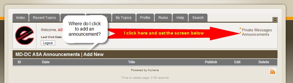

I have read, read, and read some more on how to get announcements to work. I have set the announcements to "yes" in the control panel, and set user ID's. I did everything in this link docs.kunena.com/index.php/Kunena_Announcements .So my question is...I go to the announcements link at the top...then it takes me to the announcements page. From there it all ends. I see no where I can add an announcement. I have attached a screenshot with notes.
I am using Kunea 1.6, rockettheme Omnicron template, mootools upgrade enabled, and connected to jomsocial. Again I followed the directions in the Wiki to the letter. Any thoughts on how this works...just dont know how to add an announcement.

You have a problem. The problem is caused by the Rockettheme template that is conflicting with the standard Joomla Javascript library (Mootools 1.2.4). Your question is probably answered by looking at one of these:

15 years 8 months ago #64978 by jameshenning
Thank you so so so much. The second link from Kat fixed it. It was the javascript for the "build-span" in Rockettheme templates that was the problem Here is what she wrote just in case others have the same issue:
we have a javascript driven feature called "build titles spans" which allows for multicolored titles in many of our templates, but this seems to be conflicting with the profile edit function in kunena.
in our gantry driven templates (all templates released starting dec2009) this feature can be disabled in the joomla admin under > extensions > template manager > rt_dominion_j15 (or whichever template) > advanced > build titles spans = OFF
