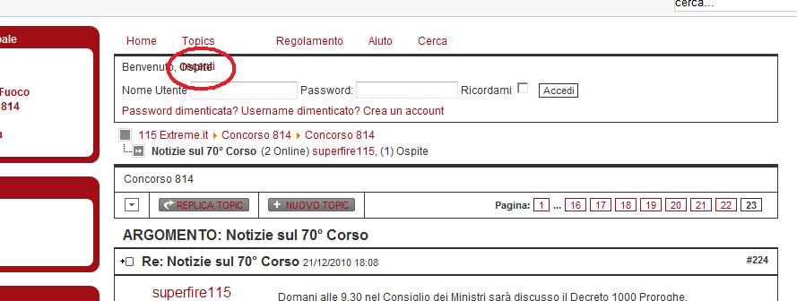

I have some problem with template.
1. If the user view the forum (no login) i have the problem show in the first screen.

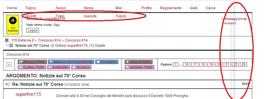

2. If the user view the forum after the login, the problem is more the problem shows in the second screen

Replied by sozzled on topic Re: Forum out of template
G'day, superfire115, and welcome to Kunena.
Thank you for your question. I can see the problem. The problem occurs if you view the website using Internet Explorer 8. The problem does not occur if you view the website using Firefox, Google Chrome, or Internet Explorer 8 running with compatibility mode.
I found what it is that causes the problem but I haven't yet figured out a solution - I'm not very clever when it comes to fixing Internet Explorer problems - and I might have to leave this for someone else to provide you with a better solution.
The Kunena CSS template has the following definition:
#Kunena #ktab a span {
display: block;
font-size: 1em;
line-height: 2.3em;
padding: 0 1.1em;
text-indent: 0;
You need to change the padding to something else. However, if you change the padding it will fix the "IE8 problem" but it will create problems when you view the page using a different browser, like Firefox, for example.
Therefore, one solution is to replace the line
padding: 0 1.1em;
with the following
padding: 0 0;
But this is not really a very good solution.
15 years 11 months ago #78423 by sozzled
I discussed this issue with the project developers and I have some good news. This issue should be fixed in K 1.6.2.
There is a simple fix that should do the trick. Change the line that I referred to above to read:
padding: 0 10px;
I hope this solves your problem. :)
