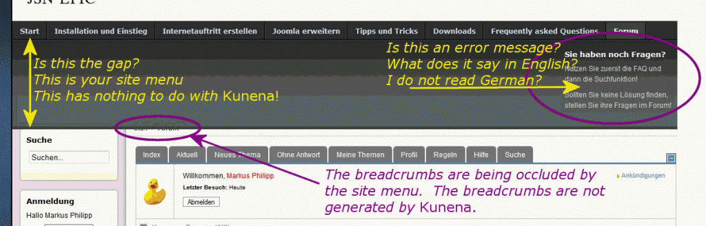

Markus87: [strike]I have asked you a couple of times, is your website on the internet?. You haven't answered this question.[/strike] I see that you edited an earlier message in which you say that your website is not on the internet. Please read Support for PC-hosted websites (e.g. WAMP, XAMPP) .
From the image you posted, your issues are not caused by Kunena. They appear to be caused by your site template. This is not a support issue and I am moving this topic to another category.
It is virtually impossible to identify what is causing these issues on a website that is not on the internet. I suggest you look at Fireboard .

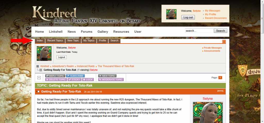

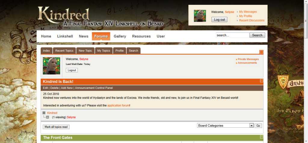

I'm having a similar issue that just started after I updated my site template. Whenever I click on a post from the index page, Kunena moves up the page and starts to cut off the menu.
How it looks when I enter the forum from the top menu:
How it looks when I click on a post from the index page:
I use JSN Dome, which is created by JoomlaShine, who also created JSN Epic (Markus87's site template).
Kunena is the only component that seems to be doing this. But if you're sure this is a site template issue, Sozzled, I'll contact JoomlaShine about it?

Moonstone wrote: Kunena is the only component that seems to be doing this. But if you're sure this is a site template issue, Sozzled, I'll contact JoomlaShine about it?
95% of all layout issues reported here (the figure could even be higher than that) are caused by or can be fixed with changing the Joomla site template CSS. I don't mean replacing the Joomla site template with another one; I mean see the advice that we've written in the FAQs page - look at the FAQs tab on the Kunena menu above - under the heading Template and layout-related issues.
If the problem just started after you updated your site template then you've probably nailed the caused. You can also fix the matter in few minutes using a tool like Firebug .
