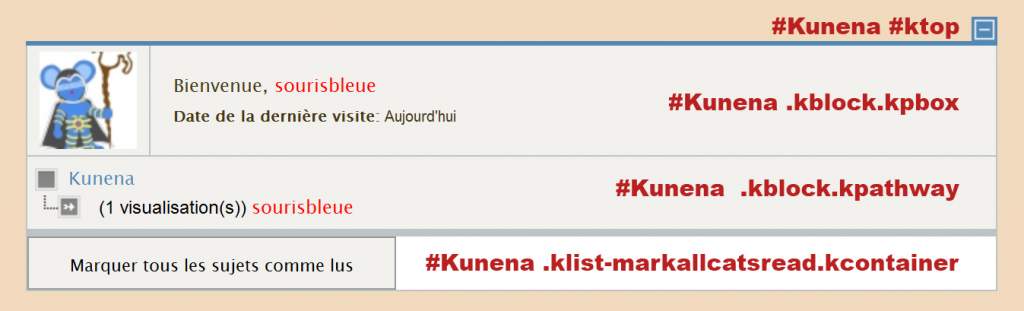

I have succeed in finding the way to hide properly all the tabs that appear in the top of Kunena 1.7 forum (using Firebug), and since it took me a lot of time (surely because I'm quite a newbie), I decided to make you benefit for the solution.
As you can see with the image underneath, there are 4 top bars :
  • The +/- box to reduce the top bars
  • The Profile box
  • The Breadcrum box
  • The Mark-all-messages-read box
The definitively-working solution, is to add at the end of the template file of your Joomla Site (the global template that gives the look of your site), the following lines :
/* Hide +/- box */ #Kunena #ktop { display: none; } /* Hide profilebox tab */ #Kunena .kblock.kpbox { display:none; } /* Hide Breabcrum tab */ #Kunena .kblock.kpathway{ display: none; } /* Hide Marked-all-cats-read tab */ #Kunena .klist-markallcatsread.kcontainer{ display: none; }
and you will be pleased to see all these top bars quielty disappear.
