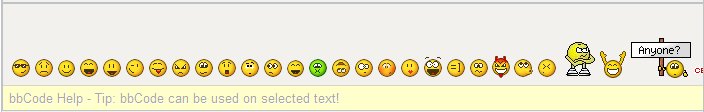

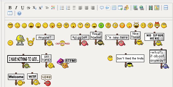

I have added a number of emotions to the forum and when running Chrome, Firefox, Opera or Safari I have no problems however with IE (both 8 and 9) the emotions are not all displayed, the fall off the right hand side of the screen. But now here in lies a problem, I have users who have the same configuration eg Windows 7 and IE9 for whom it works.

Emotions in Chrome
Emotions in IE8

In this case, the problem is caused by the Joomla site template CSS which does not have adequate provisions for handling element wrapping for Internet Explorer. This is a Template and Design issue, not a case where someone used the wrong approach to define smiley BBcode.
