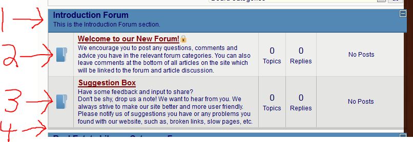

Thanks for the info. I switched so now I'm using the Kunena Blue Eagle default template, instead of the Example template. In the Kunena template editor I have the "Blend with Joomla Template" selected to "yes" and that fixed the need for me to edit the text and link colors of Kunena to match my site template. But when I change some of the forum header and other colors in the template editor it also changes all the link colors (to not match my Joomla template colors) which I don't want.
I've attached a screenshot of a section of my Kunena forum. I tried to narrow down the CSS details with Firebug but I'm not finding the correct CSS file/section to edit. In the screenshot here is what I found and what colors I want to edit:
Item #1) <div class="kheader"> For all the forum headers: I want to change the blue color to green. I want to change the text color from dark blue to white.
Item #2) <tr id="kcat2" class="krow2 krow2"> For all the forums: I want to change the background light gray color to white.
Item #3) <tr id="kcat3" class="krow1 krow1"> For all the forums: I want to change the background dark gray color to light gray.
Item #4) <div class="kblock kcategories-1"> For all the forums: I want to change the border around the sections from dark gray to blue or green.
Do you know which CSS I need to edit and what do I search for to find the correct line to edit?
Can I add my changes to the end of the CSS file to make the edits since the last command takes priority? This is what I did when I edited my RocketTheme template CSS files. It makes it much easier if I upgrade to a new template version in the future since I can easily find, copy and paste my edits to the new template. It will also make it easier in the future when I upgrade to newer Kunena versions that might overwrite the Blue Eagle template CSS files.
Also, I search the forum for "button set" to learn more about this feature of the Kunena Blue Eagle template, as you suggested. However, it brought up over 400 results but I didn't find what I needed after the first 5 pages of results.
Thanks for any advice!
Last edit: 14 years 10 months ago by nemmar.
14 years 10 months ago #110681 by sozzled
nemmar wrote: Do you know which CSS I need to edit and what do I search for to find the correct line to edit?
Yes, that's basically the advice we've consistently given and the point that's made in How do I change the colours of my template in Kunena?
