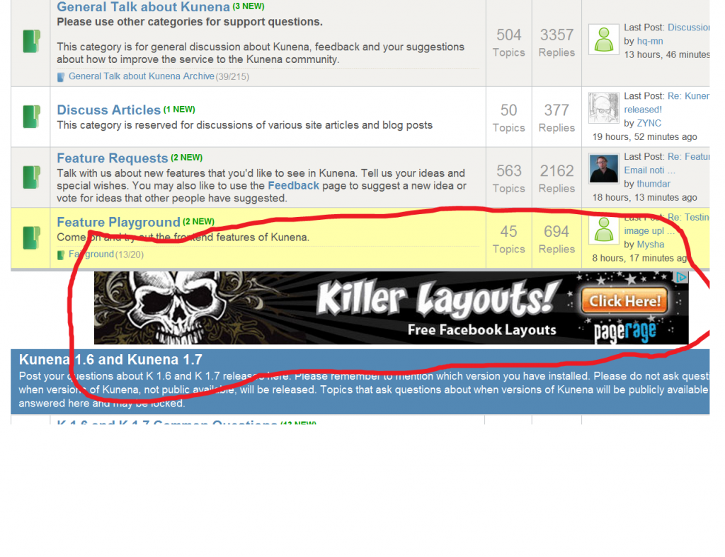

14 years 10 months ago #112059 by animator3000
Replied by animator3000 on topic Banners in kunena 1.7
I would like to know how to add banners in the forum. I would like to put my banners here:
