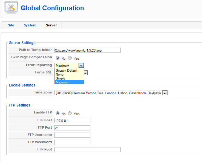

Pls kindly advise how to enable "error reporting on maximum in Joomla", I never use that before, thanks!
15 years 6 months ago #93772 by xillibit
Replied by xillibit on topic Re: Can't Post New Topic !
Like that :
The following user(s) said Thank You: dingbusan
