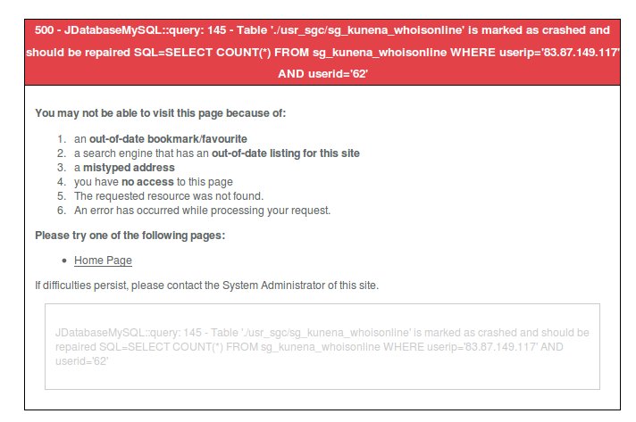

15 years 2 months ago #91688 by xillibit
Enable debug mode in Kunena configuration panel
15 years 2 months ago #91694 by harrieklomp
I have tried it and get the next screen on the forum,
15 years 2 months ago #91696 by xillibit
In phpmyadmin, in the details of the table concerned under operations tab, you need to do a repair
15 years 2 months ago #91775 by zaanhoeve
problem solved
removed corrupted tables and insert them from the dev site.
Thanks for the fast reply and help :woohoo:
