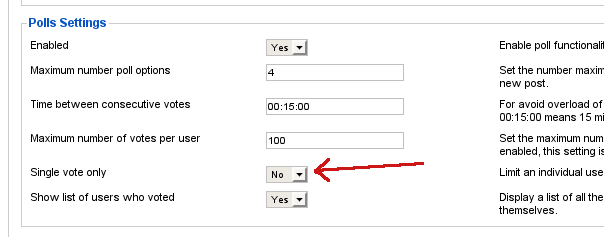

15 years 6 months ago #96333 by frenostanco
Maybe I have found a little workaround...
Don't tell me why, but I have changed (in the Kunena configuration -> Plugin panel) the option "Single vote only" from "Yes" to "No":
And now seems to work. But now I have a new problem... one can vote many times, and I don't want this!
I think that there is a problem in the logic behind the options. If I set back the above parameter to Yes, then the "Vote" button is switched in "Change vote". So, when the poll starts, users cannot do anything... simply 'cause there is no vote to change if you cannot vote the first time. :S
Maybe should I leave the "Single vote only" to "No" and set "Maximum number of votes per user" to "1"? :unsure:
This could work?
Hello to everybody!
