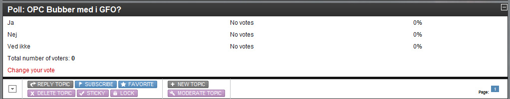

Hi.
After upgrading to 1.6.3 i cant make polls anymore. Well i can make them, all catergorys has enabled polls. But the odd thing is that you cant vote.

Hi.
This is for all poles, also others not created by me. No i havent voted. Noone am able to vote.

15 years 9 months ago #84990 by skydk
Replied by skydk on topic Re: No options in polls
Still the same, even with switched tamplate.
