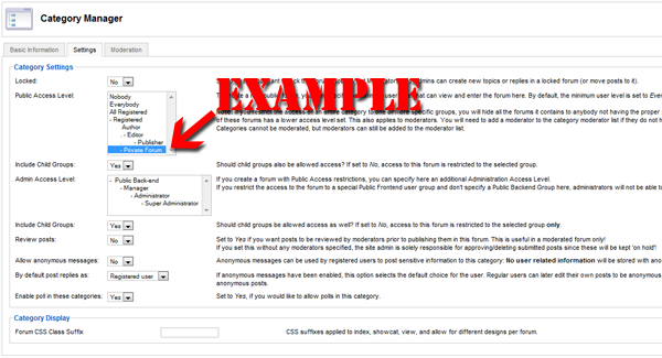

I have successfully installed this on my site and working well. The only thing I can think of that you did not add to the list...
- Make sure you have added the group to the specific forum(private forum). So when you created your new category in Kunena make sure you have highlighted the private group you created specific for that category. Oh also making sure the new categories are both enabled.

15 years 3 months ago - 15 years 3 months ago #84100 by snilloconator
You can make the parent category private as well then adding as many private sub cats. I should have mentioned the parent cat needs a specific group as well. You need to assign a group even without artofuser to see it on the frontend.
