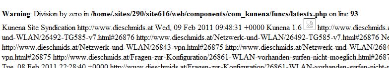

Update: I have uninstalled Kunena, reinstalled 1.6.3. but it is always the same. - division by zero in module kunenalatest. I have tried with deleting the database and reimport, fresh install and so on. It is still the same. I cant activate RSS-Feed.

Here is a screenshot of the error:

I tried to find the error in the file latestx.php:
protected function _common() { $this->totalpages = ceil ( $this->total / $this->threads_per_page );
I think this function tries to find the number of pages to display in rss-feed. So I went to Kunena configuration and set the limit of rss-entries to 30. (Standard is 0 for unlimited number of entries)
And now it works. I think this is really a bug since Kunena 1.6.1. In Kunena 1.6.0 everything worked fine, since 1.6.1 this error occurs.

Just an FYI.. It's May 25, 2011 and this problem still exists Kunena 1.6.3. I can confirm that "RSS Limit" set to 0 causes this problem. I set it to 50 after reading this thread and the problem goes away.
