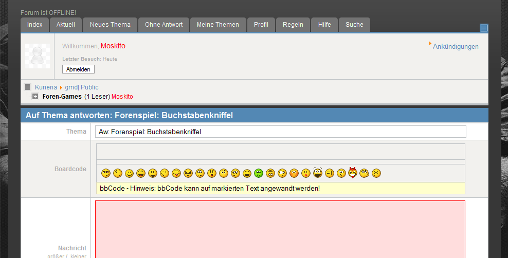

1. the bbcodes like smileys didnt work (cant klick to take it in article) see appanded image

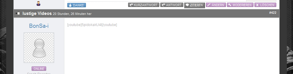

2. videocodes are wrong convertet :
codes look like this: [youtub]5pidokakU4I[/youtub] (i deletet the e not to show the video)
and no video is showing!
but it must be like this???
3. sometimes the send button dont works
i have 2 websites on the same webserver, the Problem above is with the major site (Template is from Rocketthemes), on a Yoothemes template (my 2nd side it works nearly fine)
thats it for the moment, i give you at the end the configuration - Protocol and 2 pics with the errors.

As for the bbcode tags: Kunena does not have a [youtube] tag.
First you don't even need a tag in Kunena to embed a youtube video, just placing the link into a post will auto embed it.
Second if you want to use a tag for youtube videos, the syntax is simple:
As for the bbcode toolbar missing: This means that mootools 1.2.4 is not being loaded. Please make sure the System - Mootools Upgrade plugin is enabled and comes before any other javascript or library system plugins.
