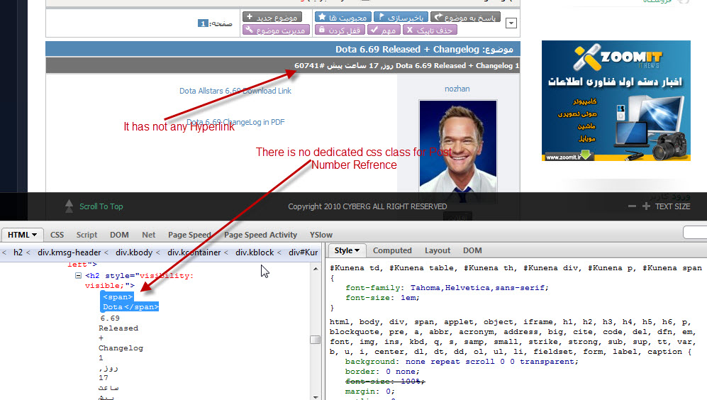

Since the first RC version of 1.6, my Post References Number and kunena profile Edit do not have any hyperlink they are just simple text span.
I've not had this problem in K1.5, at first I thought a file or files should be uploaded badly or there is problem with kunena upgrader but all Kunena function are working perfectly.
You will find the snapshot enclosed.
sample link for profile:
www.cyberg.ir/index.php?option=com_kunen...myprofile&Itemid=118
sample link for RefNo.
www.cyberg.ir/index.php?option=com_kunen...&id=55760&Itemid=118

I found the reason:
There is option in gantry template (Rocket Themes) that make this problem for solving this problem you should disable: "Build Titles Spans" in Advance Tab of you Template Setting.
