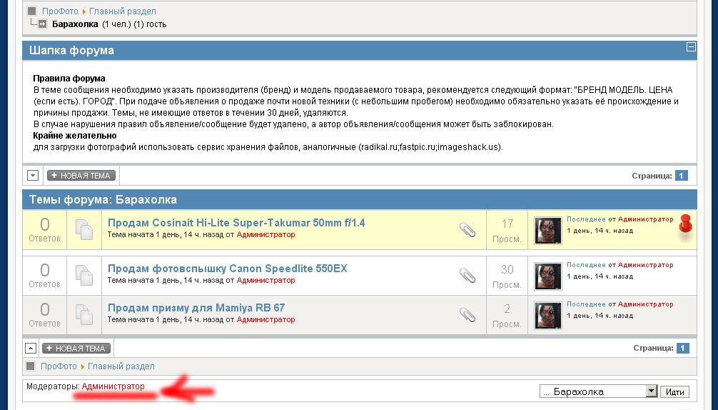

16 years 3 months ago - 16 years 3 months ago #58620 by lev
Error displaying names of moderators.
Appears only when the topic categories, and in the main section and forum threads created everything appears correctly.
To correct the climb in this file showcat.php
/components/com_kunena/template/default/threads/showcat.php
line 128
echo CKunenaLink::GetProfileLink ( intval($mod->userid), $this->escape($mod->username) ) . '  ';
Edit, Changing the line "$mod->username" on "$_user->name"
echo CKunenaLink::GetProfileLink ( intval($mod->userid), $this->escape($_user->name) ) . '  ';
All the editing is finished
I can Déjà vu, but I think the error was and K1.5.x
Actually forgot to write version Kunena 1.6.0 RC1
Tested on engine Jomla 1.5.20
Sorry for my English.
