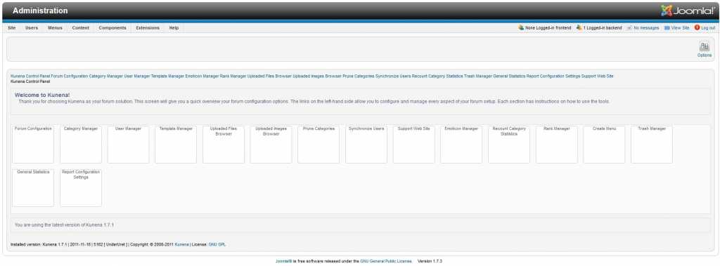

No problem with Kunena 1.7.1 until this morning I noticed the forums was offline then I went in to the Administrator side and clicked on the Kunena 1.7.1 component and it asked me to reinstall or remove Kunena 1.7.1 so I reinstalled it
Then went back in the component and found the format and images not showing up at all. So I have attached a screen shot of the site backend.
Has anyone seen this happen and how do I fix it?

I don't know what caused your problems. The fact that, when you attempted to change the Kunena configuration settings, you were asked to reinstall or remove K 1.7.1 suggests to me that the installation became corrupted. It's possible that the original installation was only partly successful.
The image you show suggests that there is a problem with Joomla. If I was in your situation, where I had, "until this morning" had no problems but was suddenly faced with some unexplained change, I would go back to my last-known good backup. Is this an option for you?

Thank you for posting that information. It helps (a little). From the looks of things, Kunena is installed (we cannot tell, without knowing the URL of your website) what other problems you may have, but at least it points to the fact that there is still some information intact in the Joomla database.
The forum online/offline setting is stored in the table xxx_kunena_config (the column name is board_offline). If your forum is offline, the value of board_offline will be 1. You can set your forum back to online by changing this value to 0. However, that probably won't fix up the problems you have with your Kunena configuration control.
Another way to recover from the catastrophe is to DROP the table xxx_kunena_config. If you then try to use Kunena, Kunena will attempt to rebuild this table again from a backup. This method doesn't always work.
As I mentioned earlier, I've seen this problem before with J! 1.7 (although not, specifically, with J! 1.7.3) but I can't recall how to show you what we did to resolve the case. As I recall, I had to spend a couple of hours digging into the innards of Joomla to find the problem and to remove all traces of an abortive attempt to install Kunena. Let's try the simple things first but I have fears that it's going to be a big job to try to patch things up.
