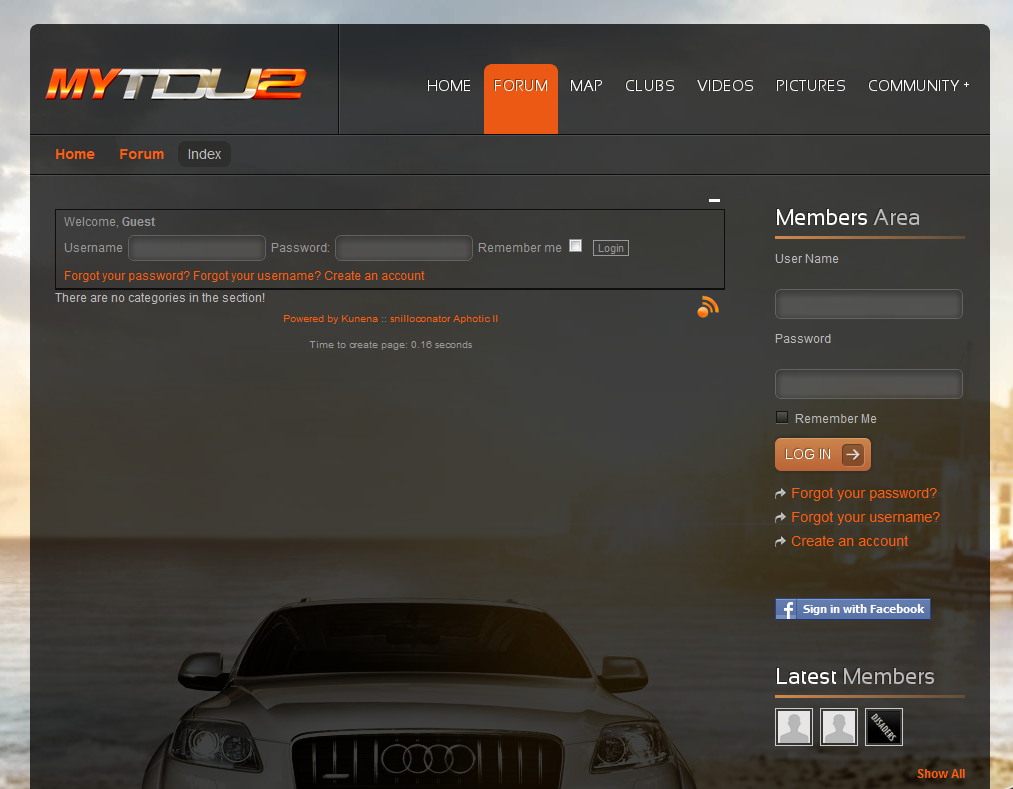

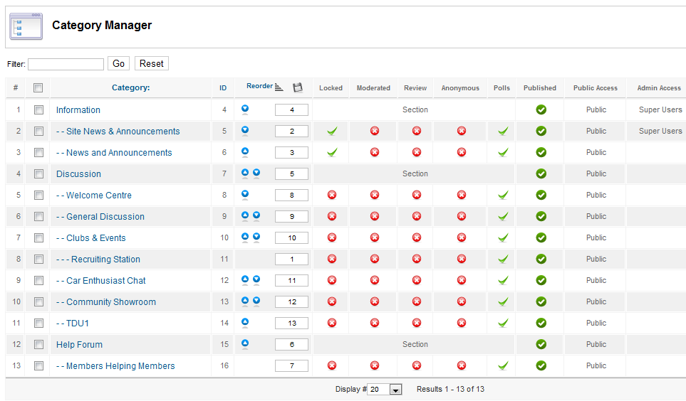

I have all the permissions set correctly to public viewing, but guests cannot see the forum categories at all.
Guests have their own group but it's parent is Public, which seems to work everywhere else except Kunena.
I have attached 2 pictures so you can see the settings and the error.
Once logged in everything works normally.

15 years 6 months ago #94298 by 810
please check your settings:
Forum Configuration- Security- Registered Users Only , must be "No"
regards 810.

15 years 6 months ago #94366 by 810
hi,
Did you upgreded from J1.5 or did you did a clean install on j1.6. Please go to your Category Manager and select a Category and save it again.
regards 810
