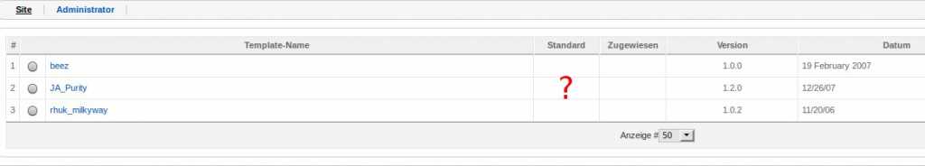

Please go to "Backend > Extensions > Template Manager" and mark your template with a star.
That should help you.

i think, that's a old joomla 1.5 bug. It's no template selected, but the template even so works correctly. And when you want create a configuration report, then there is this error 500.
Line 3465 is:
Line 3465 is:
$templatedetails->version = $templateversion->data();
