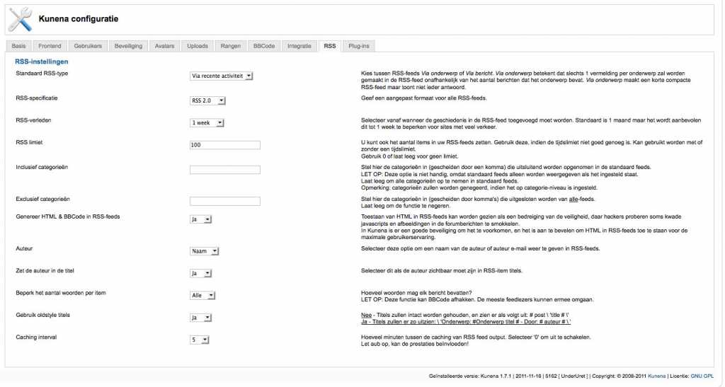

Question Why does my RSS feed only show topics from the last week?
It is showing none or just a few messages.
The URL is feed://www.fan.tv/index.php?option=com_kunena&func=rss&format=feed&Itemid=0
See attached screenshot with settings.
I don't know what I'm doing wrong. Someone any idea?

(2) See the posting guide (printed at the top of this page) and include your configuration report - it's a lot easier to read the configuration report than it is to read an image.
Perhaps the reason you are only seeing a few messages is because of the RSS settings you have chosen. That makes sense. It would also make sense that, for example, if your settings were "show me the topics updated in the past week on the RSS page" (and you did not have any updates in the past week) there might be nothing to show. The fact that the link you gave us shows that there is one topic seems to indicate that the RSS function works. I don't know any more than this at the moment, without seeing your config. report.
Posting your config. report will generally help us to give you help more quickly.

Your config report says "Show topics updated in the past week."
Your site has only one topic updated in the past week. There is not issue problem here that I can see.
If you want a larger RSS feed page, change the RSS settings.

Afterwards clear the cache, to see the RSS result.
