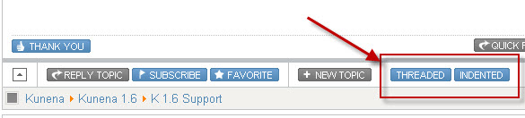

Here in kunena I see more buttons like Threaded & Indented.
How I can enable it in my forums?

The threaded/indented view is an experimental feature of K 1.6.4 and this experimental feature is not officially supported. However, if you want to try this experimental feature on your website, I will show you how it is done.
Please not that the way to implement this experimental feature requires that you need to change a field in your database table. Changing your database is not something that should be attempted by anyone unless they are completely aware of the risk that they may make their Joomla website totally unusable if they make a mistake. Before making any changes to the database you should make sure that you have a good backup of your website. Please also read How To Destroy your forum data...
As long as you accept the risks involved
, this is what you need to do:
Use a database tool like phpMyAdmin. In the table jos_kunena_config, change the column value enable_threaded_layouts from 0 to 1

15 years 6 months ago #94341 by thug_boy
Oh !!
I think this feature is available in K 1.6.4 and I think there is something wrong with upgrading process officially.
But if there is a risk in enabling it then I wouldn't enable it especially when I'm not experiment about editing databases tables. So I'll wait for enabling it officially in the next releases :)

15 years 6 months ago #94343 by sozzled
There is nothing wrong with the official upgrade process. As I wrote, the threaded feature is not officially included as part of the K 1.6.4 release. The feature is disabled by default. If you want to use the feature you need to manually enable it; I have shown you how it can be enabled. :)
