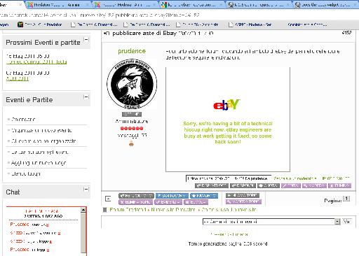

No eBay APP ID and/or Cert ID defined in Kunena configurationFrom our site this ebay code give an error..
But from here.. on your site is ok:
This is an auction from italian ebay
What is wrong on our site?
The error as attachements

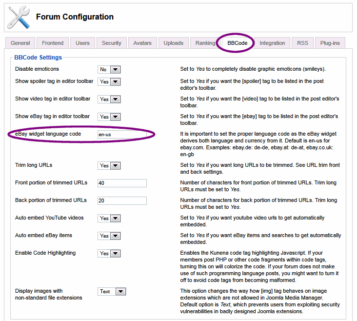

15 years 7 months ago - 15 years 7 months ago #93012
Replied by sozzled on topic Re: problem with ebay
The problems that some people have is caused by how they've setup their Kunena configuration. The eBay widget does not work with all language variants. For example it does not work with en-au (Australian English); it may not work with it-it, either. The widget works with en-gb (British English) and with en-us (US English) which probably explains why it works here at
www.kunena.org
Look at your configuration settings and let us know what you are using. See the following screenshot taken from the configuration here, at www.kunena.org :
