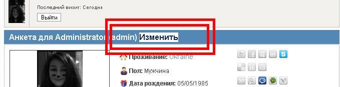

15 years 10 months ago - 15 years 10 months ago #80065 by Helixir
Replied by Helixir on topic Cant edit profile
Hi all.
I cant edit my profile (
Lastest kunena installed.
Open my profile - and link "Изменить"(in english "Edit") not clicable :(
Installed Russian language.
Last edit: 15 years 10 months ago by Helixir.
The topic has been locked.
